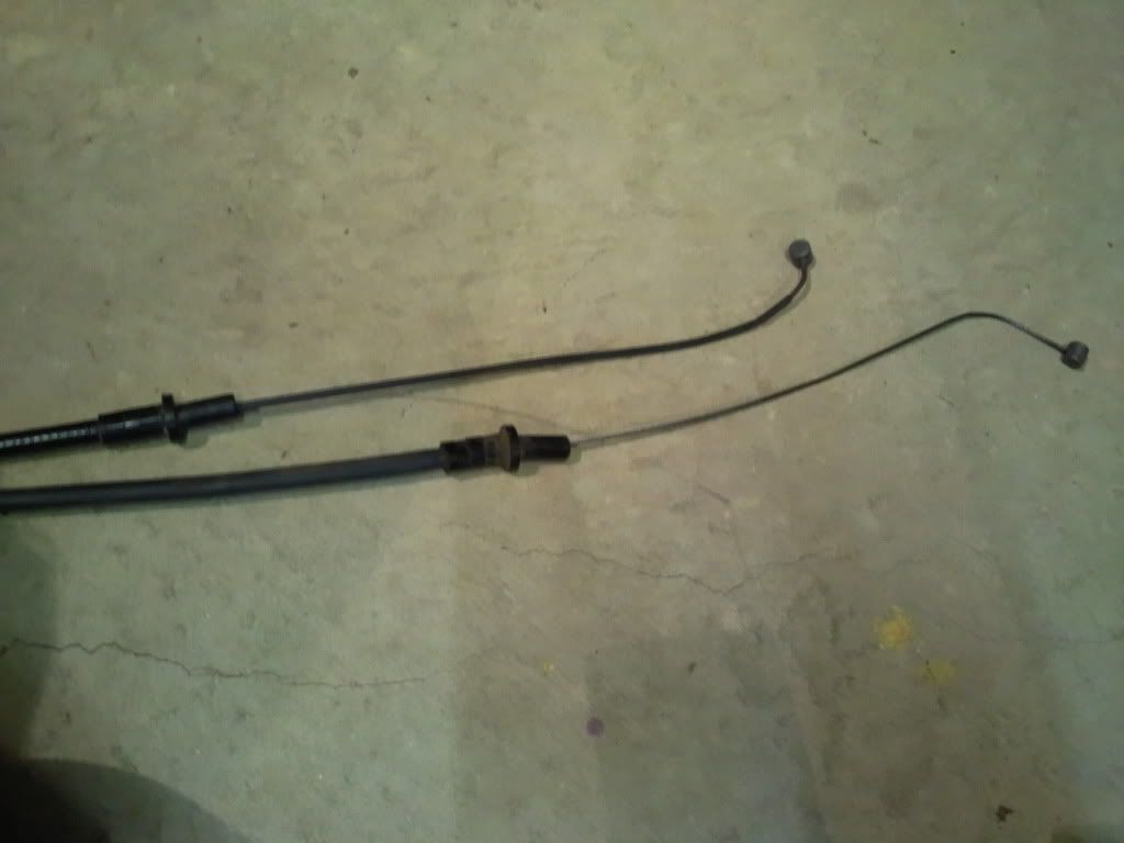

Seems like a good opportunity to fit those twin carbs at the same time? I just need a Fiat accelerator cable.
Re: LC Lancer hatch
Fiat cable? Would've thought the stock cable was compatible...
Re: LC Lancer hatch
No, not long enough. can't buy the GS cable in Aus to my knowledge, but a Fiat 131 cable is perfect. It's ball both ends, I just cut the end off, and used a screw on barrel type end. Has been on my wagon for 7 years now.geezer101 wrote:Fiat cable? Would've thought the stock cable was compatible...

I (after a bit of drama with someone else) got a company called Conwire in Milpera to make mine for the coupe. Had to be made custom and they knocked one our perfectly for $40 with a two day turn around. I was pretty pleased with them.

GE sigma accelerator cable is what i use,was told by ron at coltspeed many years ago when i got his last twin carb thermastat housing.75wagon wrote:No, not long enough. can't buy the GS cable in Aus to my knowledge, but a Fiat 131 cable is perfect. It's ball both ends, I just cut the end off, and used a screw on barrel type end. Has been on my wagon for 7 years now.geezer101 wrote:Fiat cable? Would've thought the stock cable was compatible...

Ohhh, thanks for that, I won't forget that77GDWAGON wrote:GE sigma accelerator cable is what i use,was told by ron at coltspeed many years ago when i got his last twin carb thermastat housing.

How short is the standard cable Dave? Not sure how long the lancer cables are, but compared to a GD, the GE GH Sigma cables are "roughly" 100mm longer, and are identical ends of course75wagon wrote:No, not long enough. can't buy the GS cable in Aus to my knowledge, but a Fiat 131 cable is perfect. It's ball both ends, I just cut the end off, and used a screw on barrel type end. Has been on my wagon for 7 years now.geezer101 wrote:Fiat cable? Would've thought the stock cable was compatible...
Pic:
Good to hear it's all back together too! Got some pictures of the finished(/ repaired) product
