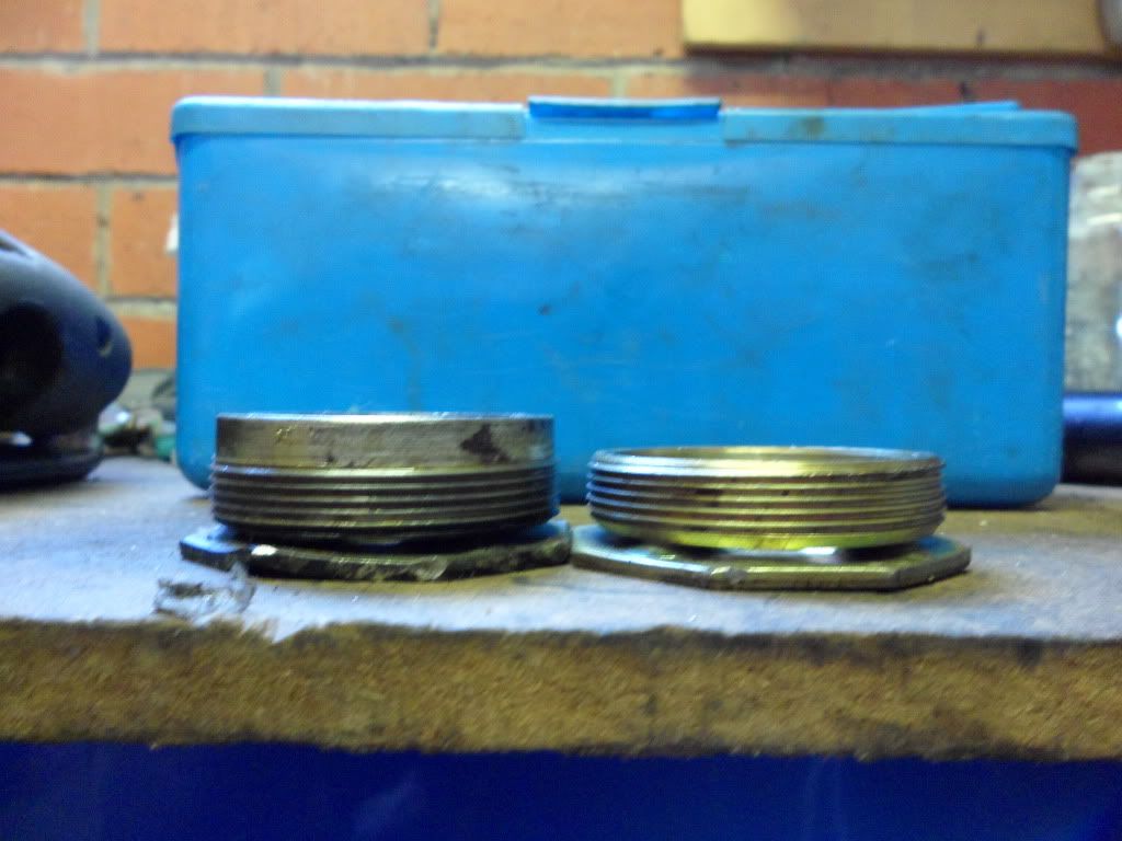

sounds like the commo inserts are about the same size as centura insert
I found the centura insert was 10mm shorter in the body and about 40mm shorter in the ram, didnt need to fit spacers or cut the strut tube to get the nuts to tighten down I just used GJ retaining nuts
the GJ nut also has a nice dust seal pressed into it

amgis- im guessing the GJ gland nut is the one on the left? so you didnt put spacers in the bottom of the strut tube, and used that Gj nut to compensate for the height difference?? are there adjustable inserts available for centura's?
My brother plays with a few of them so i might go have a look at his parts collection today and have a fiddle around with some old wet legs.
what does it drive like with these inserts in the front? I realise its going to be quite different if i use them in my lancer, cos ive got a astron compared to a clevland.. but on the other hand i reckon they would be quite stiff..?
cheaterparts- what free lenght coilover springs are you running, any chance you could measure them? Ive got 8kg/cm ones from ottomoto but unsure if they are too stiff/soft for my apliccation?? i can always change the springs.

No spacers just the long flange nut, I dunno if there adjustable inserts for the centura, Car drives nice and is somewhat stiffastronturbo77 wrote:amgis- im guessing the GJ gland nut is the one on the left? so you didnt put spacers in the bottom of the strut tube, and used that Gj nut to compensate for the height difference?? are there adjustable inserts available for centura's?
Galant_GT0 I measured the commo insert @ 22mm same as the centura and same as the GH units i removed

ok so cheater has spoken! i want the ride very stiff but i reckon 6kg/mm=335lbs apparently???
so i need to try 275lb to start with?
according to the KONI online catalogue the only insert available for a camira is part no.86-2348sport, but what does 'sport' mean why cant it say wheather its damper adjustable???? i was also looking into the for sale add that B20 has on here for his wagon where he states it has cut down struts and celica st165 i think inserts??
also tonight i grabbed a old centura strut out of the barn and pulled the insert out, its a lot differnt in the sigma strut, looks like it may need shortening 20mm... and was a smalled diameter aswell, but im not sure if it was a 6 cylinder centura strut or a 4 cylinder one LOL
what do you think of the otomotto universal strut tops?? im a tad worried that the aluminium plate they are made out of may be too thi n and break if it went up a curb at the race track.. will give them a call on monday.

Koni sport are adjustable - however its done by pushing them closed and turning the shaft these are the inserts I useastronturbo77 wrote:ok so cheater has spoken! ( thats scary isn't it )
these tops are on a couple of track cars both 1600 dattos I made these up around 1999 and did a set for my sigma
at the same time - all are still in use and are aluminium
they dial on more caster as well as camber - unlike a lot of adjustable tops these are more fixed
to adjust them there were 12 tapped holes but only 3 get used by the std strut tower
so by using different sets of holes ether more camber or caster dailed in
then the final adjustments done by the caster bars and the camber bolts with snail cam adjusters in the front end

I may just go with standard camira inserts at this stage, proving hard to get what I'm after. The ottomoto tops in the link abouve i would like to use but mount them with two sets of holes so i can angle them in the strut tower to adjust camber and castor when they are adjusted. I also plan to use ecentric camber bolts in the lower control arm bushes.

koni strut inserts for camira's are no longer available..
