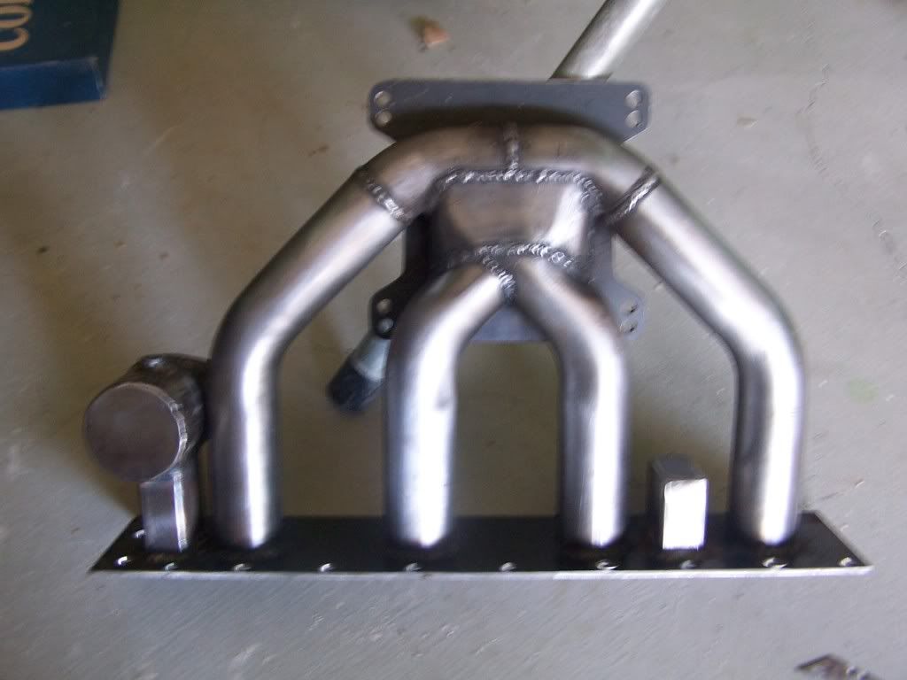

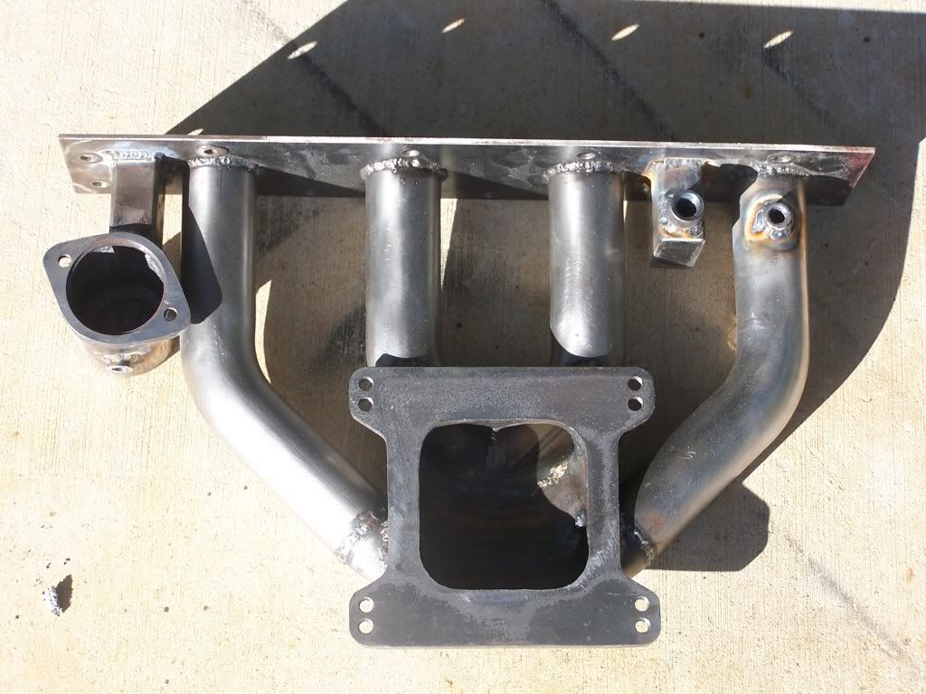

Yeah Im looking at making my own. Im having trouble finding 4cyl holley intake manifolds on the net. Anyone got any pics they would like to share?
stealth
Posts: 1038
Joined: Wed Mar 18, 2009 3:59 pm
Location: Gold coast, QLD
Re: Holley manifold
Post by stealth »
well i dont really like sharing but !
cheers stealth (H)
Engineering the unfair advantage !
Red bull , fuelling the fastest race cars on earth !
4g54gemi
Posts: 42
Joined: Wed Jun 30, 2010 4:58 pm
Re: Holley manifold
Post by 4g54gemi »
Thanks very much for that, great pics. What size are the runners 1 3/4 or 2" ?
