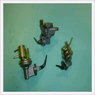

You are correct Bob, the fuel pumps for the 4G32B (belt drive motors) are not a serviceable item. They are a sealed unit.
I can't remember what the brand was that I bought for my hatch, but I remember it cost around the $100 or there abouts.
The pump you're after for you Lancer looks like the one on the bottom left.
I just went into my local parts store and bought bought one off the shelf. I was surprised they had one :o
